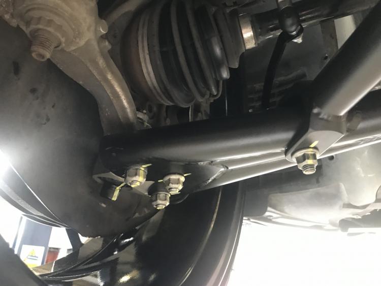

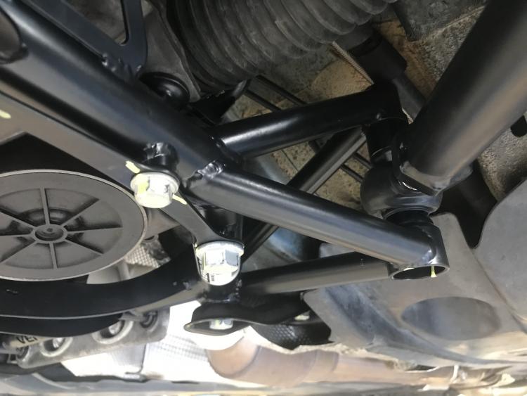

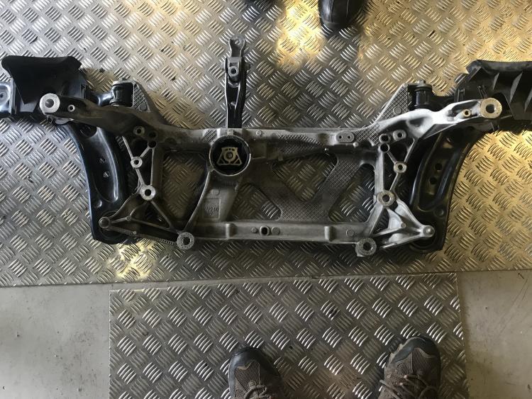

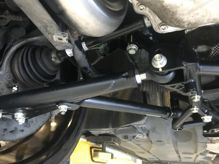

Popped down to see the progress and got to see the Verkline subframe and wishbones all fitted:
First picture is the original one and the others showing the new one. I couldn’t believe how slimmed down it is in comparison.

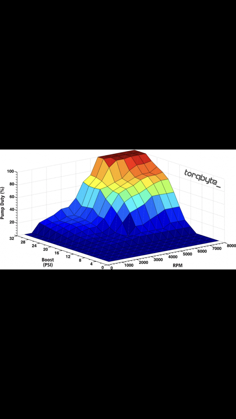

The new WMI controller is now wired in with 2 digital fast acting solenoids and a distribution unit that everything plugs into. Luckily I can keep the Snows display to show boost and bottle level due to multiple Can inputs. Not sure what else will be displayed but it’s being connected to the P3 gauge also. The picture below shows a graph of how the 3D map works:

Just found out that the 3D water/meth map is a bespoke map and not a base map like I thought. Pretty simple, they send the logs over for the last dyno run and Torqbyte send a file back. Once the final ecu mapping is complete the logs are sent again and they will decide if it needs any tweaks or not.
Hopefully I will get to see how the mapping has gone tomorrow and when I can collect it.
