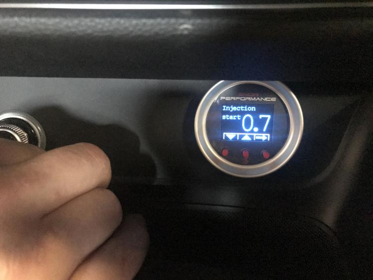

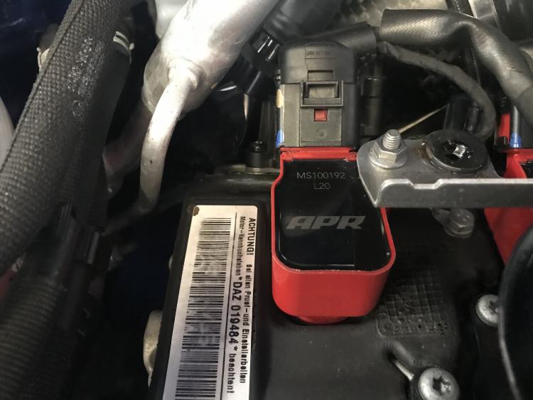

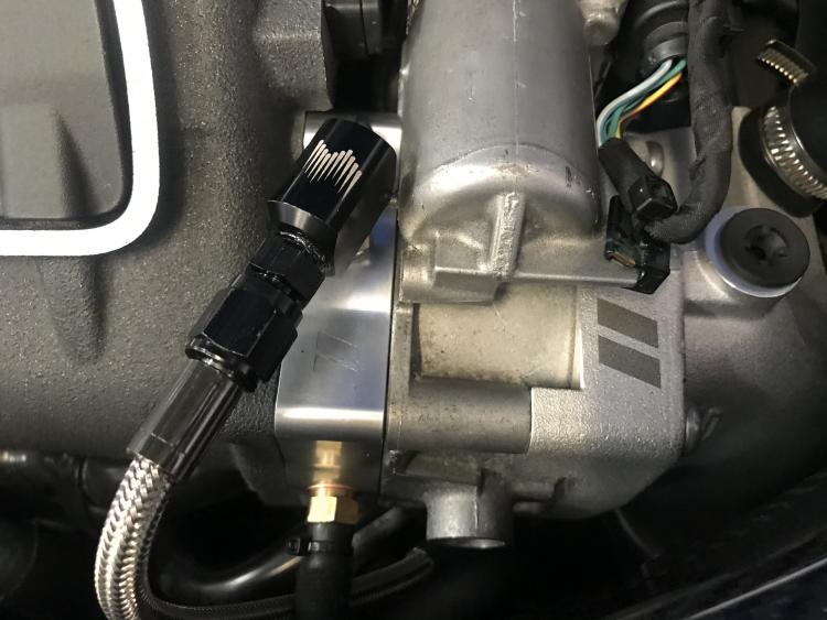

Today the WMI was wired in and the 2 jets fitted at the same time as installing the adapter plate and throttle body elbow. One jet is in the adapter plate and the other in the additional air intake hard pipe supplied with the CTS kit that joins the elbow.
Also a better shot of the APR coil packs.

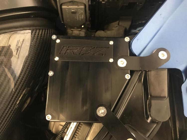

Almost forgot the IROZ DSG catch can is fitted now.

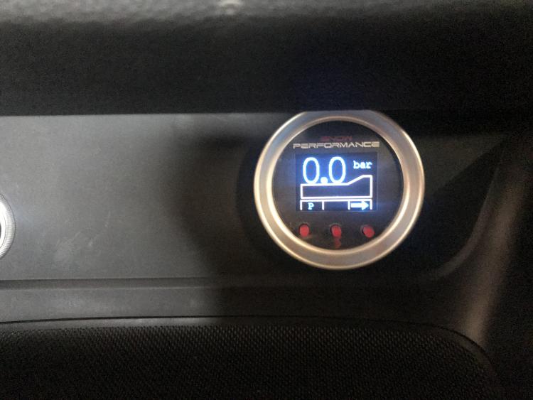

Ok so today the car was driven to check the WMI is operating correctly at 0.7 bar. The checks included recording temperate and amps being drawn. This makes sure the WMI pump is working to the manufacturers specification and it’s not just a reading on the gauge. They also needed to make sure the car wasn’t bogging down due to incorrect jet sizes. The jet sizes were specified by Snows based on the engine cc, power increase and current temp data. The jet sizes can be altered but this is a good starting point before the mapping is done.

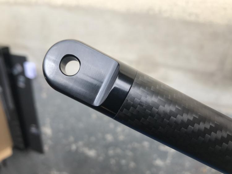

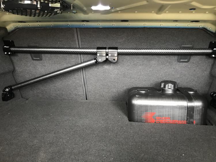

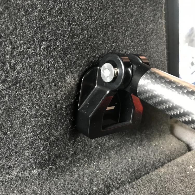

The Racingline rear upper body brace is a very well made bit of kit but sadly I couldn’t quite finish the fit due to the bottle being in the way. I reckon I could have moved the bottle by 3 inches to solve the issue but in involves cutting the cable ties and pulling the wiring through, so I’ll leave this to Regal when it next goes back.

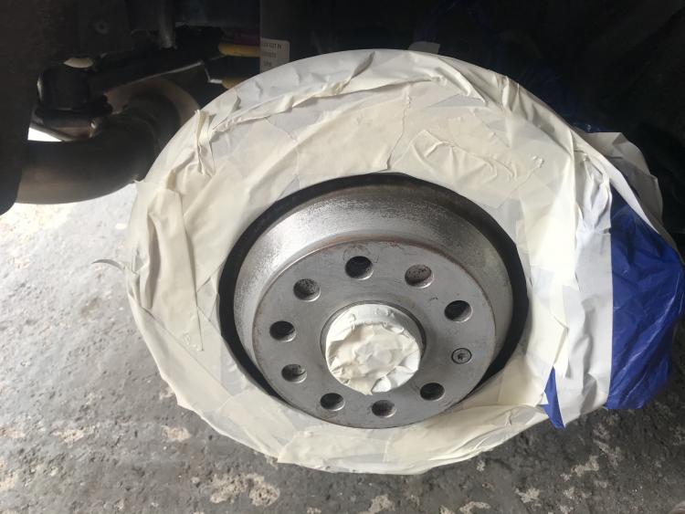

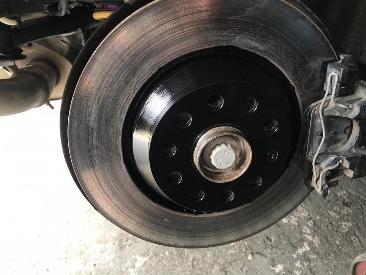

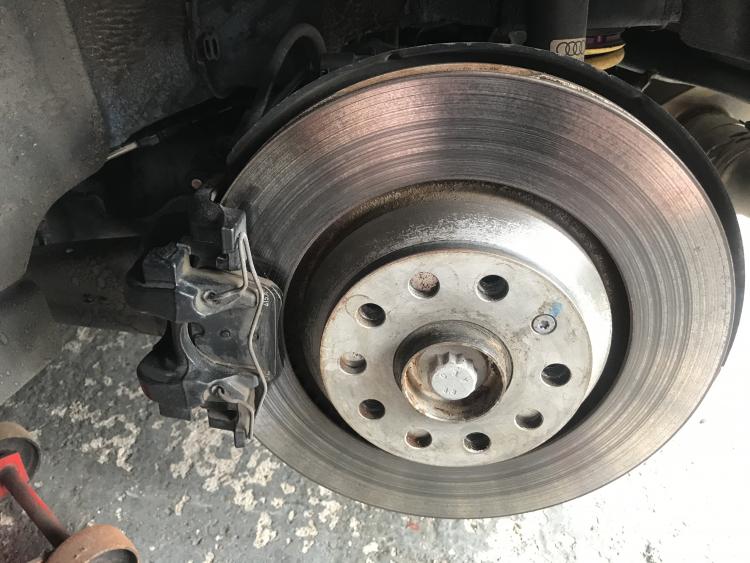

The next job I did today was paint the rear brake discs. I was contemplating removing the discs until I spoke to Dell and realised it wasn’t worth the hassle.
A simple wire brush, blast off with the air line and thinners on a rag got it ready for a couple of coats of spray Hammerite smooth black.

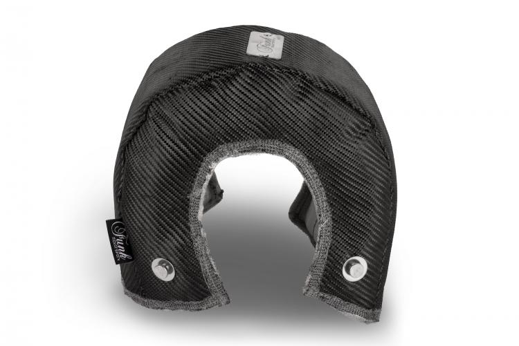

In my bid to reduce engine bay temps I have just ordered a Funk Motorsports turbo blanket designed for the TTE turbos. I am hoping someone knows a bit more than I do regarding the phenolic intake manifold spacers and replies to my other post.
I realise RS3s make a ton of heat compared to a lot of other cars so I am interested in anything that can reduce temps. So far I have the ceramic coated downpipe and WMI. Any ideas?
#160
Stu.
If you are going to use a phenolic spacer you may find your need to modify the direct injection fuel rail as it bolts to the manifold which your moving away from the cylinder head.
As you using WMI I don't see the need for a heat break spacer on the manifold especially if you may need to modify the fuel rail in doing so.
Personally I'll vent the bonnet rather than wrapping the turbo in a blanket tbh.
