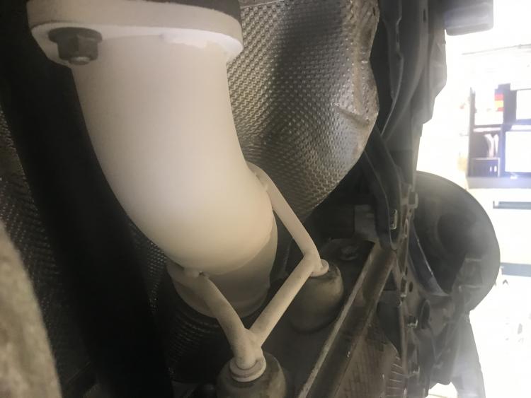

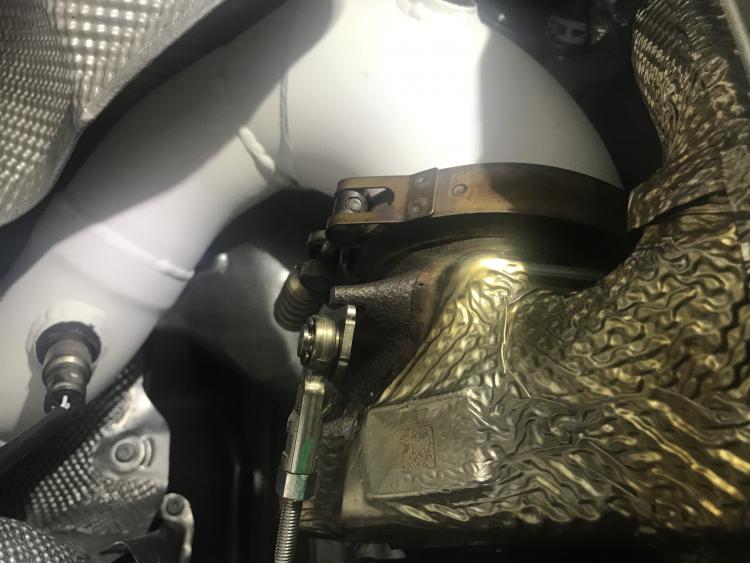

A quick update, the downpipe is no longer going to be wrapped and is now at a ceramic coating specialist instead. I have forgotten the exact figures but it has far better insulation performance than the wrap. Next week I will get a file with build pictures and will start posting some.

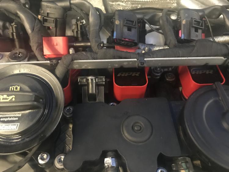

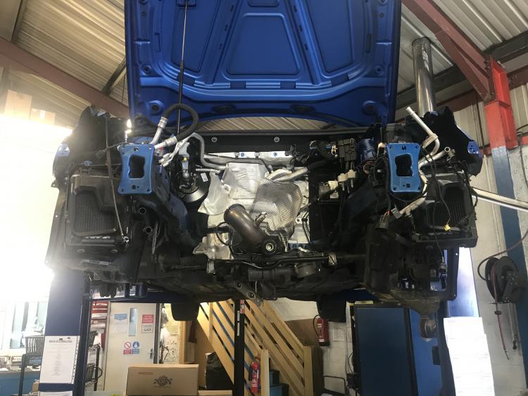

Not sure who coated the manifold due to the person arranging it being off. Good news is the TVS race clutch pack arrived, was fitted and the engine & box were reinstalled today. ![]()

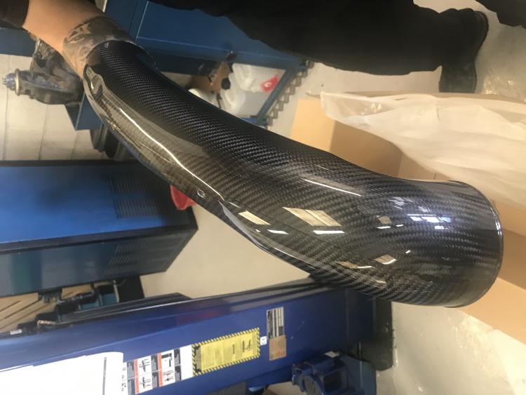

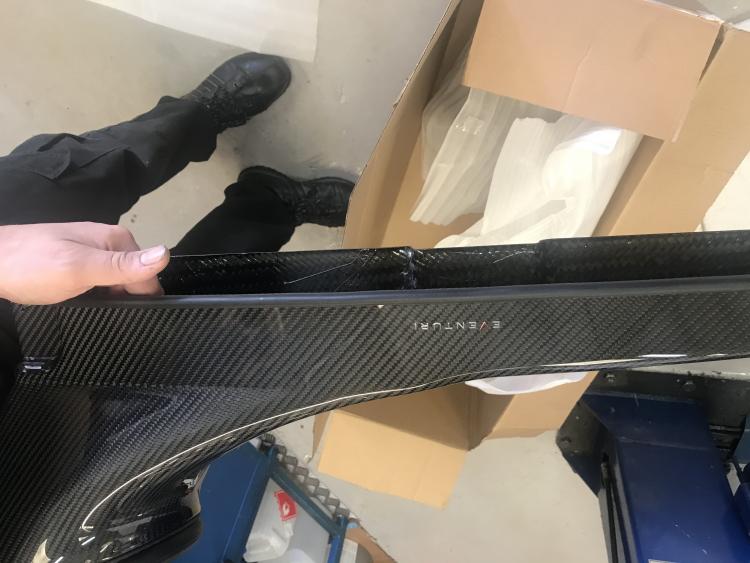

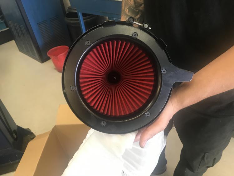

I was very impressed with the Gen 3 Eventuri intake. Apart from weighing virtually nothing the build quality was superb. I always like them when they had the Gen 1 and 2 versions but they hadn’t done enough work to get the improved power figures to a level worthy of nearly £2.5k with the turbo elbow.

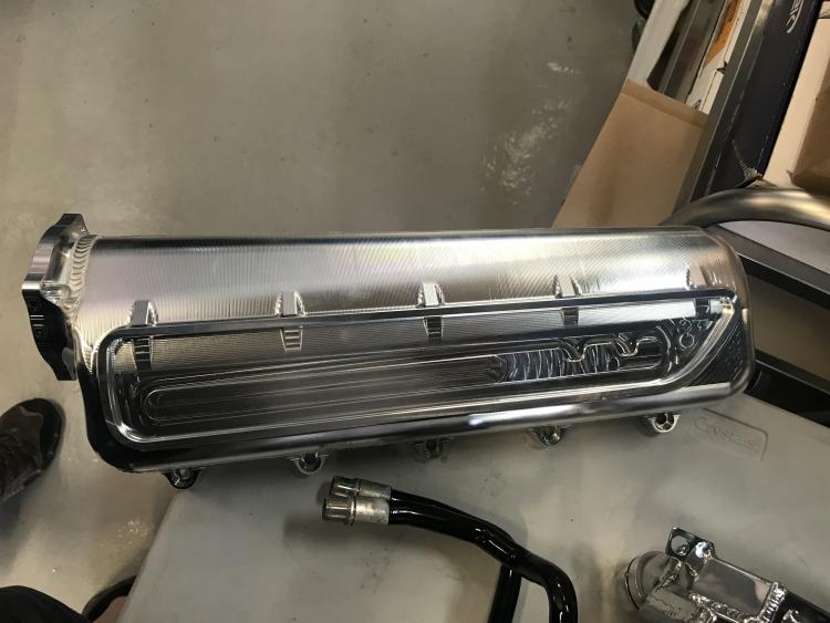

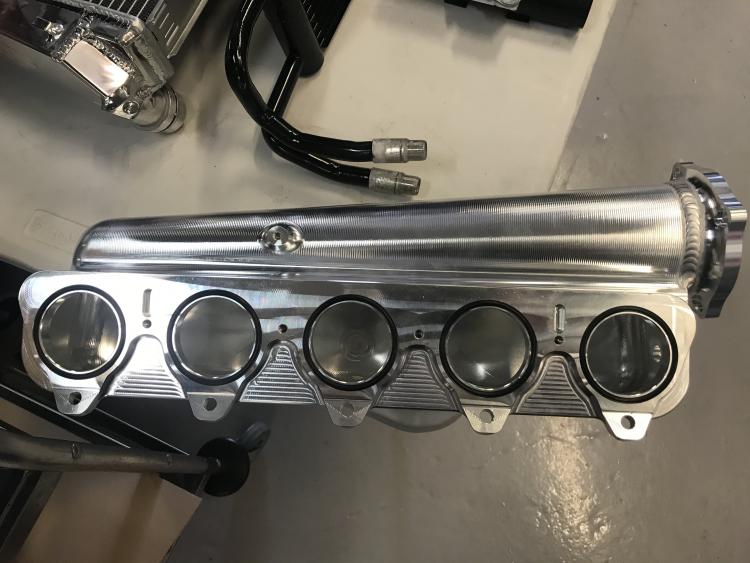

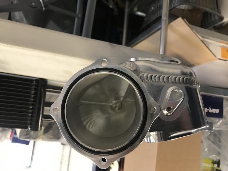

The low boost running in map will be on next week and the procedure will be completed before fitting the plenum chamber, throttle body and uprated injectors/pumps. This is to keep things simple and not spend time messing about with fuelling during this crucial period.
