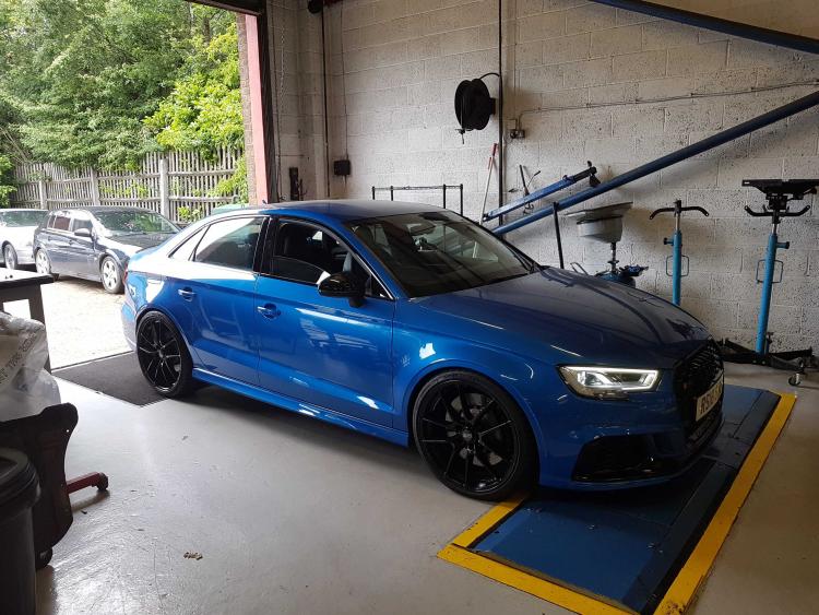

Just had the low boost running in map done and the new wheels & tires are fitted.

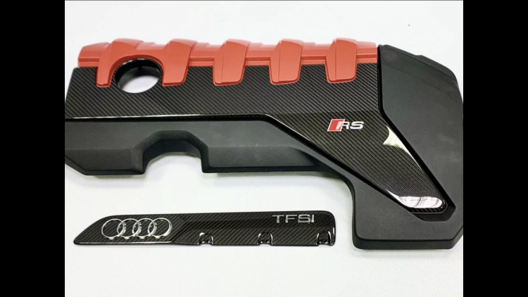

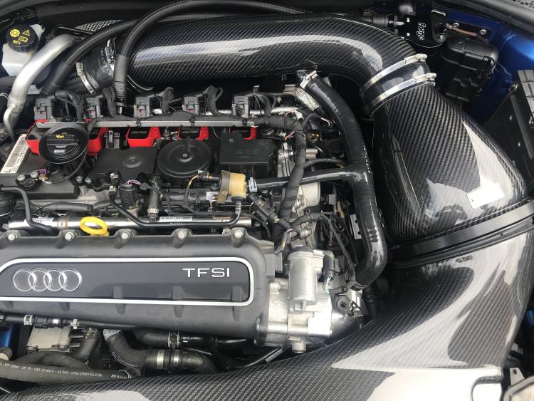

To go with the nice carbon fibre Eventuri gen 3 intake I bought a 034 carbon fibre fuse box cover. I decided I may as well finish the engine bay off properly and bought a new genuine Audi carbon fire engine cover and plenum chamber badge. 😁

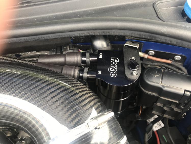

Collected the car for the weekend to get 400 miles on it. The intake looks massive now it’s on and I have a Forge engine catch can when I thought it was an 034. It’s been so long I forgot what I ordered. 😂
I’m now stopped at the A43/M40 service station getting a drink and a KFC Zinger 😃

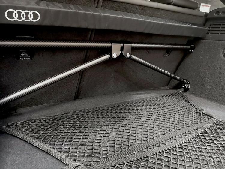

Just ordered the new Racingline rear body brace which has been designed for the Saloon. It will take 4-5 weeks to get it due to being on a limited first time production run. They are carbon fibre with billet aluminium.

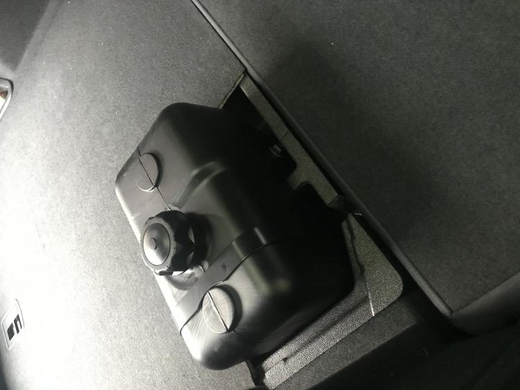

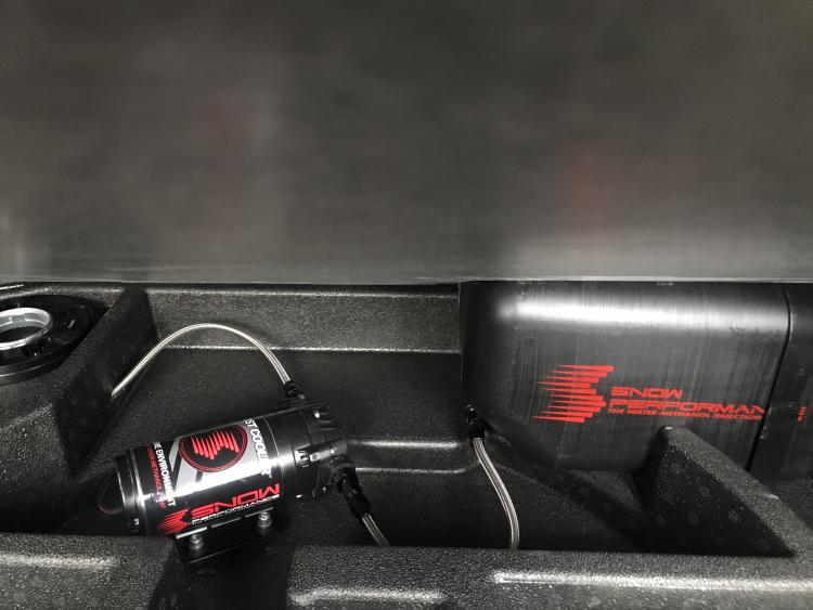

Popped past Regal today and they were just fitting the WMI ready for mapping next week. The rear floor was being altered to fit the tank at the very back, with access to filling by pulling down the rear seat instead of struggling to lean in the boot or having the tank further towards the opening and getting in the way of boot space.
The line is armoured and being fitting under the car protected by the covering that houses existing wiring. They are utilising the adaptor plate supplied with the CTS throttle body which has 2 tapped holes for WMI or NOS. Lastly the gauge will be fitted in the centre console out of the way next to the 12v supply socket. I will take some more photos when I collect it tomorrow.

Picked it up this afternoon and just driven up to Leicester. WMI is now fitted except for the nozzles. The plan is to have the 1st nozzle come in at 10psi and the 2nd at 20psi.
It’s just as well there is plenty of room under the rear floor to install the pump and easy access to connect the earths to the battery. The second picture shows the back seat down for easy filling.

Are Regal doing switchable mapping so you can run without the meth?
Yes a low boost map for daily driving that doesn’t require WMI to work so there is no issue if it runs out. The high boost map will require WMI as it will be mapped with it running, including the timing being optimised. There’s a gauge in the centre console so I’ll know if I’m running low.
#140
This is the kit I have but with the upgraded armoured pipe work and a much bigger tank.
