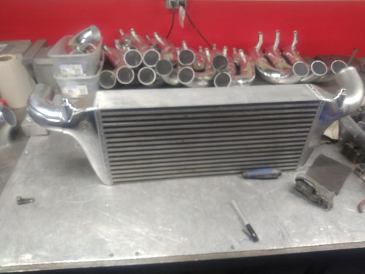

CFS intercooler on route. First picture I have when completed. I am looking forward to comparing to the OEM and Forge ones and will post the pictures with measurements.
Shiny, shiny. Looks very much like the ones they use in the states from IROZ and RACE3. Should work really well.
#246
Probably a similar size because I know the IROZ 1000hp core is also too big to have a crash bar. Really interested to size it against the oem and Forge ones.

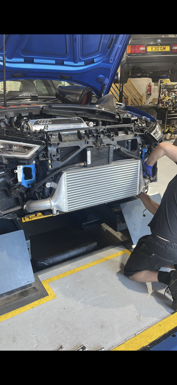

1000hp IC in after a new bracket being made to raise the oil cooler up. The SRM end tanks are way bigger and better shaped than the Forge ones, so should help keep the IATs down.

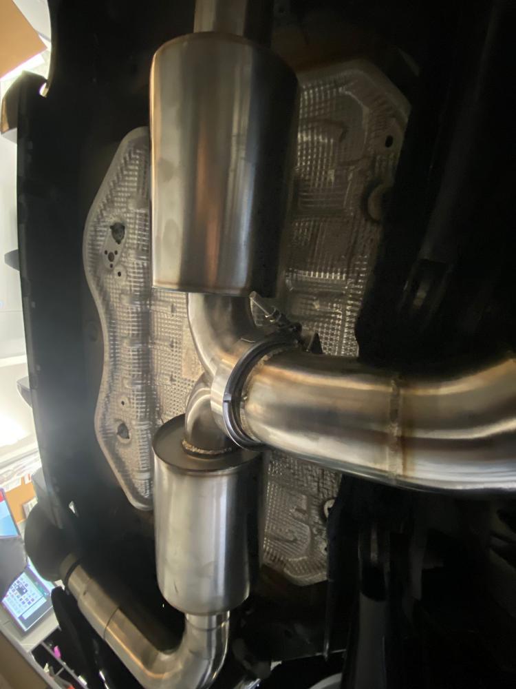

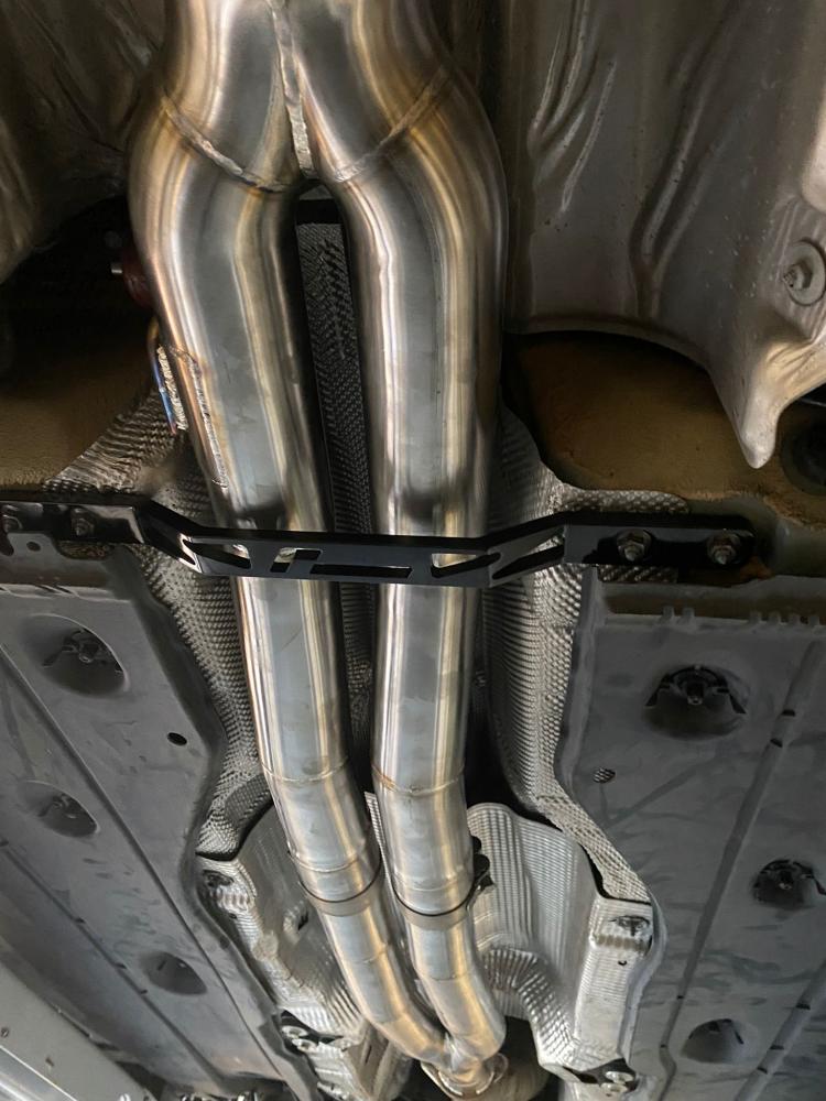

Hopefully I will be collecting my car from EBR tomorrow after fitting the inconel exhaust system. I can’t wait to hear what it sounds like because I’ve not found any done previously on the internet.

Exhaust is really good but way too loud for the street. Louder than any RS3 I’ve ever heard and it’s setting off my neighbours car alarms, so BRE are making new silencers for the rear which hopefully will be fitted in the next couple of weeks.
