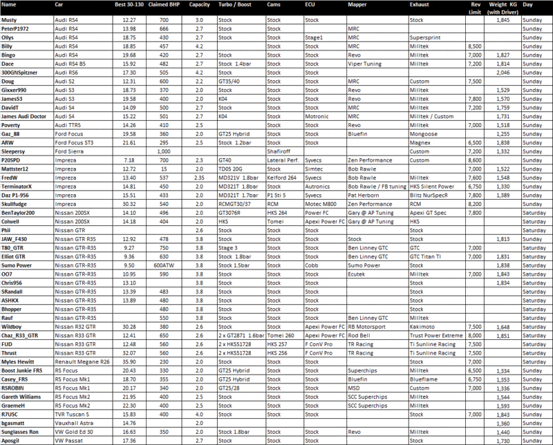

Can you work out 30-130mph time as that is a good indicator of a fast car?
I haven't got a 130mph run from yesterday as I didn't quite keep my foot in for long enough.  126mph was my vmax yesterday. I do have a log that was done quite a few months ago though, when I had the boost leak.
I have taken the run time from 30-126mph yesterday and compared that to the older run (same measure), and yesterdays run is .5s quicker for this measure.  I then took .5s off the older run and that comes out at 12.47s (corrected) for 30-130mph.  Not exact science, but gives you an idea.
Here is a table of data from a previous 30-130mph day in the UK (2013).  All data is via a VBOX.
Makes interesting reading..... ;)

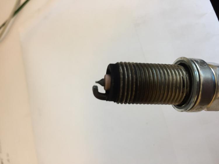

First things first.... spark plugs.
Just ordered a set of the NGK R7438-8. Not cheap at £30 a plug, but I've heard a few stories of others like stock and denso plugs dropping tips.  Can't afford that going on, so need to buy something I can trust.
These are an 8 graded heat range, so one step colder than stock iirc.

Been looking at spark plugs myself recently and trying to understand all the technical stuff behind the different heat ranges etc (something I have never really taken a close look at)
Any chance you could explain the differences/advantages of running the different graded plugs with stages of tune?
#292
Brian
NGK & Denso the higher the number eg NGK 8 or 9 is a colder plug then a 7 The plug gets rid off the the heat from the tip quicker than a plug with a low heat number eg 7.
A standard RS use a 7 heat range plug in NGK but when going to say a stage 3 tune you might use a 8 or 9 to offset the increase in combustion temperaure.
Hope this is of help mate  :)
#293
What he said. :D
TBH.... you don't need to change plugs on Stage 2, but it may be advisable to swap out every 10k regardless.  At Stage 3 (say 500bhp) it's more about added protection with the increased heat.... and not risking the tips falling off.
However, if you go too cold a plug for a daily driver they can foul up easier.

Interesting to see how the tip is recessed into the plug body and the angle of the electrode compared to the standard Audi plug below (the pic is a plug thats done nearly 9K miles in my engine)

I do not know if it helps but for stage 3 on the S3 engine the -9 NGK's are needed, -8's cause misfires.
#296
Apparently on the 2.5, the 8's are fine.  They better be.  :D
