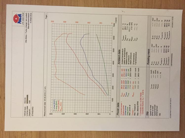

FPF,
Would you mind putting your graph up mate?
#226
Oh just to say - our car had the SW update done a couple of months ago.
#227
Seems like a few people are jumping from a 3 to a 7............................. well 2 are  :lol:
#228
FPF,
Here you go....
#229
After almost 20 runs on the Dyno at QST last Monday, all I really drove away with was have your car/engine etc checked by Audi..... (added to the fact Charlie at SRR was surprised my MTM result was lower than the stock result on his Dyno.. I was a little.... hmmmm.. hesitant let's say, to see what Audi said...)
I was confident the car/engine was healthy after a punishing run back from QST last week though (stock), it returned no unwanted sensations, hesitancy, smoke, vibration, stutter (anything you can think of)....
So yesterday, my car was into Portsmouth Audi to be "health" checked on their diagnostics machine.....
I also asked them to apply any/all TPI's and software update available for my car.....
...Suffice to say it returned 100% healthy from their perspective, nil problems or faults recorded in the ecu. Also, there are nil outstanding TPI's or software updates that could be applied to my car, my ecu software is still at version 003 (current latest for my VIN, say Audi, though we know some are at version 005), and Kim suspected this ecu version "may" have messed with the M-Cantronic in some way and we were hoping it would be updated to potentially resolve the issues observed.
I'm now back to see Kim on Friday to see we go from here as according to his Dyno, my car only produced 375HP tuned, with some improvement on Tq (so as to why the car "feels" better than stock when using the bum-dyno).

#230
..interim continued..
Having had a discussion with Kim this morning, he feels I've been a little too... negative... towards the MTM box in my recent posts and that I have deliberately posted information to point fault towards, and only towards the MTM M-Cantronic.
Now, I feel, and expressed to Kim this morning, that I have posted with the sole intention to be neutral until we find the root cause of the dyno results returned on my car at both SRR and QST (I even recall saying this to UF earlier in the thread).  So at this point, my car could potentially still be the problem, opposed to the M-Cantronic, ergo, I have subsequently booked it in for, post discussion this morning, an independent, full health and diagnostic check with a very well recognised and respected Audi tuning specialist - this will give just about every possible readable/measurable engine related figure anyone could ever be interested in to see once and for all if my engine is behaving as it should, therefore lead onto the next stage if it either is, or isn't healthy.
Kim wanted me to also point out why he thinks my engine is not healthy, this is because, from his dyno report, my car is "massively under powered" and only produces 368hp max (stock) measured on Monday.
..to be continued.. (once I have the independent health check completed)..
