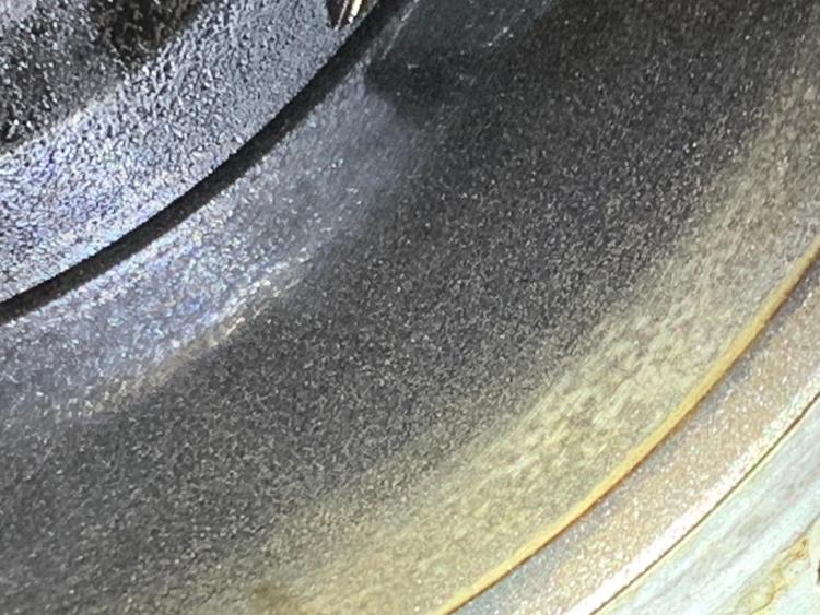

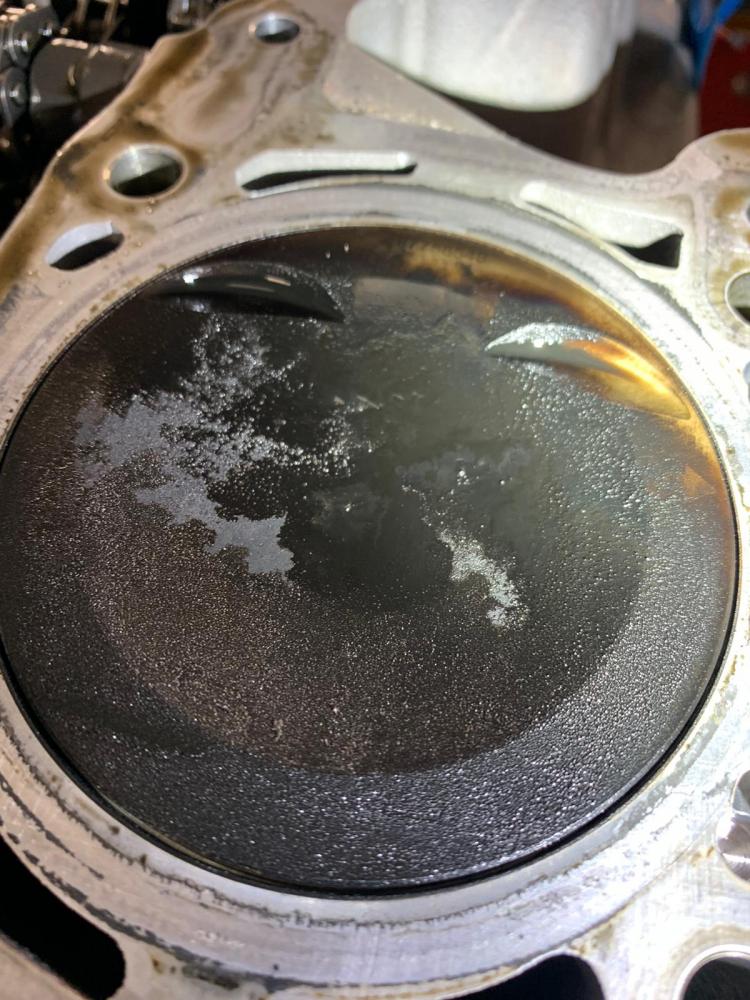

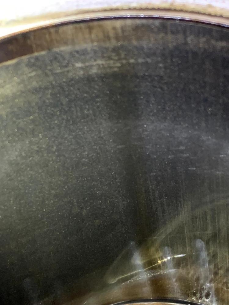

PHOTO-2019-11-22-14-41-37.jpg PHOTO-2019-11-22-14-41-34.jpg PHOTO-2019-11-22-14-41-33.jpg PHOTO-2019-11-22-13-51-03(2).jpg
Edited by Buchrs3, 25 November 2019 - 08:34 PM.
#275
That's the pics i got sent... tbh I dnt knw what wrong I'm looking at...

If you look very closely it appears that one of the valves has been JUST touching the piston.Cam timing out.Also the
bore finish is totally wrong.Not enough pressure on the honing stones.That could account for the scratches on the bores
as it won`t be holding enough oil.
.I know some independant engine specialists that will give you a written report if you need one.
