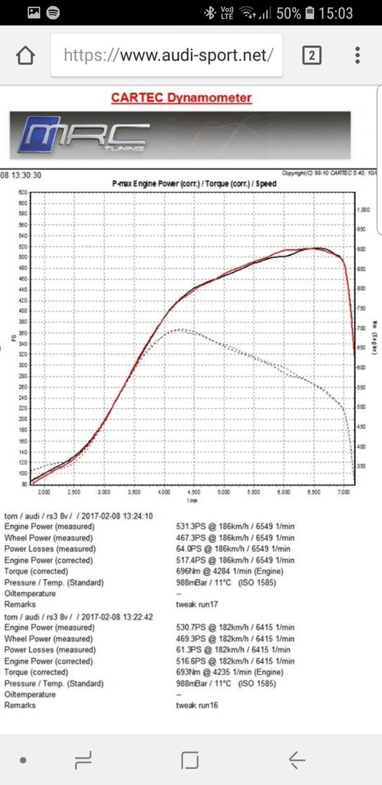

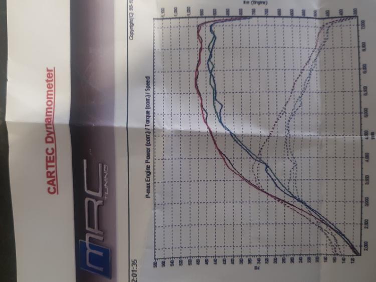

After a bit more research and looking at many more graphs and talking to some great RS3 owners, that I may say are very knowledgeable. I have noticed you can not compare the 8p against the 8v pfl, it seems they act very different even from a stage 1 2 tune.
Here is a couple of graphs with a tte500 mapped by MRC with similar specs. As you can clearly see our hybrid instantly has the advantage low down, and also holds torque really well across the mid range. It does not peak and die off.  There unit at 3krpm is only at 200ps if you compare to our graph at 3krpm we are at 280ps massive difference and must feel insane on the road. Also we hold alot more torque. So i can only imagine driveabilty would be perfect. The last dyno plot is of our turbo.
We will be fitting this hybrid to our 8p, so we can compare.

Hi Ben,
How about getting a Vbox strapped to the car running your hybrid turbo, this will give more meaningful numbers than the dyno chart debate.
I have been out in 8P's with big turbo conversions, run my own PFL car with numerous mods to stage 2 by MRC and have driven my friends car also with a stage 2 MRC tune. All of them have impressive dyno sheets with big torque figures (the 8P being the highest incidentally) but all of them drove differently. My car was like a crazy thing with instant go, my friends was super smooth and one of the fastest 1/4 mile times by a daily driven UK car and the 8P pinned you to the seat during any in-gear acceleration.
I think what I am trying to say here is that each of us has a different perspective as to what makes a 'better' or 'faster' car. To some it may need to be the best drag strip hero, others may want drive-ability or maybe just even some pub talk dyno numbers. And here lies your issue. Most will make a decision of buying a certain conversion or performance upgrade based purely on the claims of the peak numbers achieved regardless of how they would like their car to drive.
The Vbox is probably the only way to find a common ground (benchmark).

To be honest, the v box is our next step.
With the greatest respect it's not all about hp! We have got 760nm the highest by far on 99ron. Do you think a 530ps car with 680nm is going to beat this?? I think not
Very nice figures!
It’s not all about torque though imo. It’s about the right powerband for the intended use and overall setup.
High torque figures can be great, but when it’s in the mid range it has a specific benefit. It’s great if you punch it in any gear lower down. However, if you’re gunning it through the gears mid range torque is a moot point. It’s all about the power in the upper rev band.
