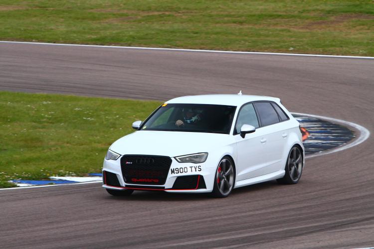

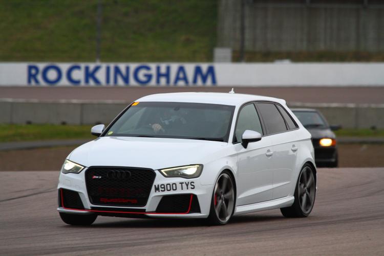

I had the track pack on the car for around 4 months I was really impressed with it it’s totally fine for a daily drive.
You will find he trackpack is a lovely balance between both the rides firm in dynamic and soft in comfort the ideal medium for all variety of driving.
It’s really surprising how nice comfort is you really fell the dampeners at work rather than the solid OEM setup which seems cancels them out, both modes feeling quiet similar.
Trackpack has been the most popular with 8v owners giving you the best of both worlds improved comfort to OEM and a really balanced in the corners without the feeling of understeer taking over..
The pictures below are me on track front and rear running stock map, once I went upto stage 2 I wanted more firmness to support the extra power I was running.
