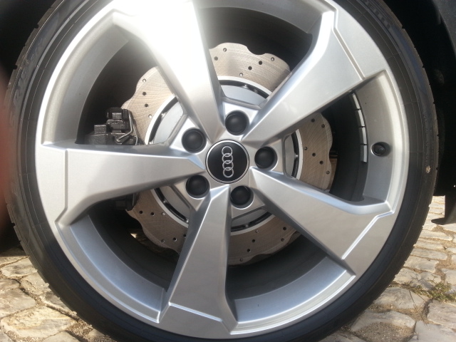

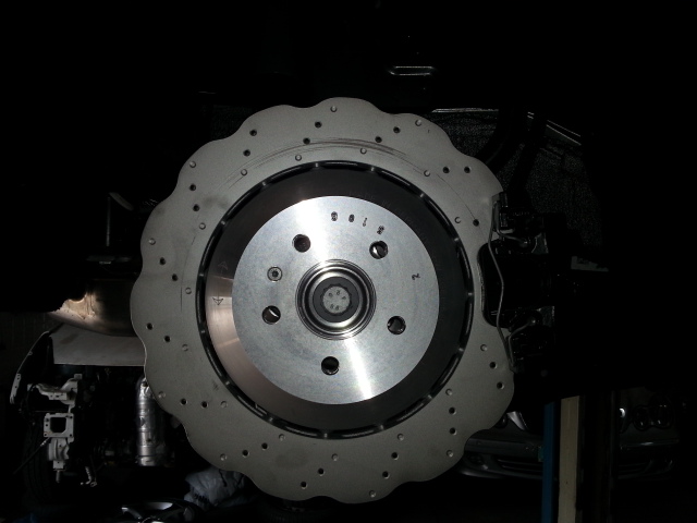

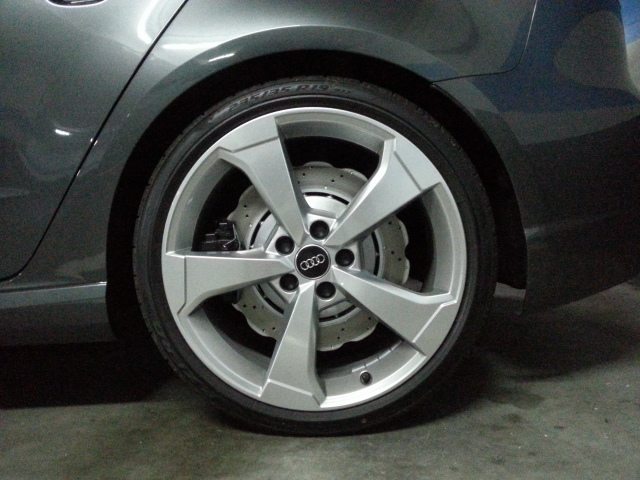

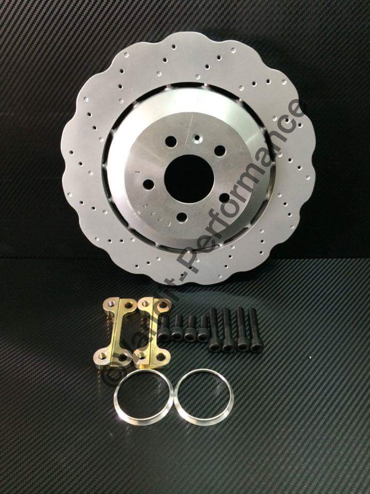

I wanted the rear RS7 brake discs retrofit because the stock rear discs looks out of place compared with the front brake system and all the RS exterior look. But spending +1500euro on a kit when you can buy a set of RS7 rear discs for 600euro in ebay, it was hard to accept. Finally i found vandit-performance.de that sold me a kit just under 1000euro. This is for brand new and genuine RS7 rear brake discs + adapters for stock calipers + centric rings for wheel hubs and bolts. Now it looks balanced between front and rear and even the stock wheels look alot better.

To me this already looks odd..........
The OEM pad isn't big enough to sweep the entire surface of the bigger disc, you can even see signs of it on the picture behind the alloy.......
You'll end up with an odd looking band near the hub and on the wavy edge where the disc is untouched...........
Each to their own though........ :)

The pads do cover the edges of the disc wave shape. At this moment all the edges is cleared and has a even sign of wear like it shown at the middle of the discs but the band near the hub remains the same. That pic was taken after a 10km of soft drive. The short drive and gentil braking wasn't enough to remove the protection coat at the wave edges. When you brake soft, the pads won't apply a equal pressure on disc surface due to the single piston design.
About braking and at higher speeds, i don't feel anymore the braking relying only at front. It is definitely a upgrade mod for look and function. But if it was only for look, i would be happy as imho the rear tiny disc hurts the RS style.

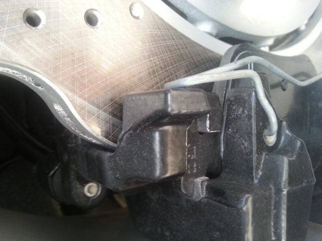

Please explain your theory...
As i said above, the pads don't cover the disc only a few mm at the inner, next to the hub. Can't see any issue on that. The further the caliper/pad from the hub, the more leverage and brake force will be applied.
Fair play the wavy edge looks better now....
However that inside band will remain untouched because the original pad ain't wide enough.
But you are happy with it so its all that matters.

For those wanting to buy the rs7 kit from vandit-performance
I urge you not to send Bernd any money just yet
It's been 6 weeks since sending him funds and there has been a complete freeze on replies and no product being sent to me
A fellow Aussie purchased from him recently too and is getting the same silent treatment
I will update this thread if he delivers
