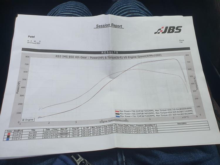

It's been 5 months lol. Ive had the car back and it made 756hp and 650ftlb torque. It sounds and feels amazing.pure monster it is.
Its gone back for a few tweeks on fuel pump should recieve it back soon.

C'mon Buch that graph's lovely but itchin for the video!
#215
Lol... soon as I get it back I will. Not had proper time with the car myself...

Looks great, puts you back in the seat id imagine lol

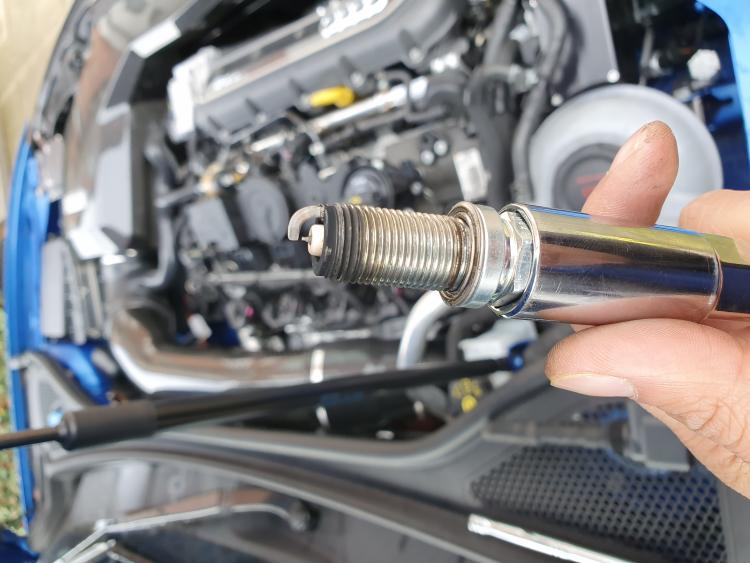

So I keep gettin missfires in cylinder 3... when I'm thrashing the car it's fine. The car will go thru the missfire and drive normal but only when I'm thrashing the car..
Plug 3 seems to be gettin wet with fuel when I'm strolling around town at around 20 to 30 mph cruising...

That's the plugs gettin dry after thrashing it...
So you can imagine how wet they get on the tip If I dnt thrash the car to clean the plugs

Plug 1. This one looks fine...
1 and 2 and 5 will be similar..
3 and 4 get wet..
Whilst I'm driving around you get a strong smell of fuel also...
