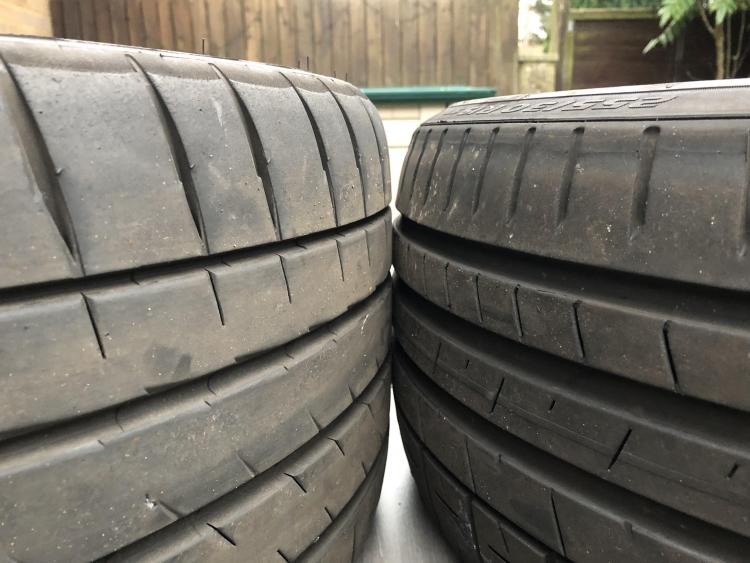

The 255/30 section Michelin next to the 255/30 section Pirelli.....

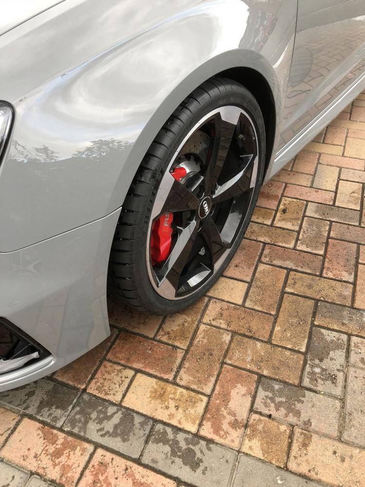

The 255/30 Michelin fitted to the front 8.5J alloy. If you zoom in you just see the slightly 'bloated' look of the side wall of the tyre. Like it's squeezed onto the alloy.

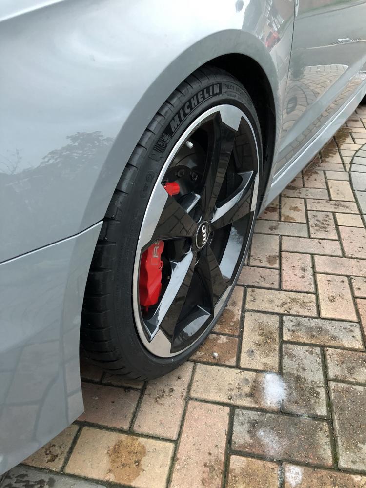

....and the 235/35 Michelin. The side wall looks much better and has a higher profile (35 versus 30)
