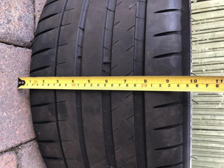

Michelin 255

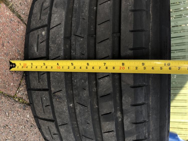

Pirelli 255 [although this looks like 260mm if you measure the tread that only contacts the ground and not the rim protector on either side its only around 230mm[

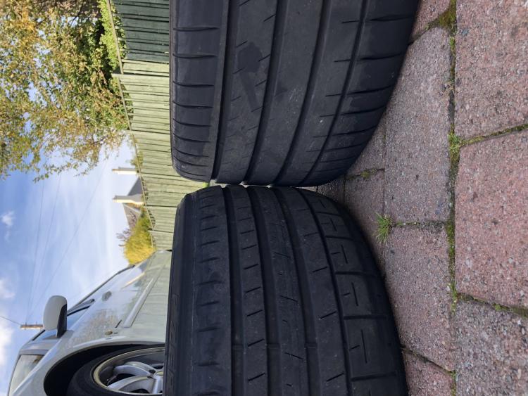

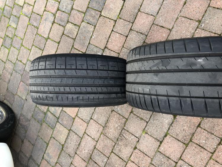

And a few side by side shots. You can see how badly the inner of the P-Zero has worn after 9000 miles
