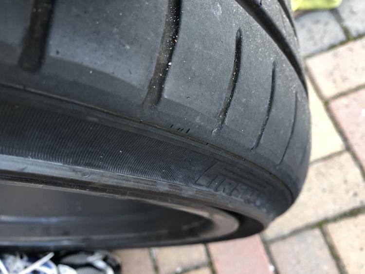

And a few side by side shots. You can see how badly the inner of the P-Zero has worn after 9000 miles
RE: The worn edge of the tyre. There are others reporting similar extreme wear issues and I am wondering if we are seeing an emerging issue with the way the Pirelli tyres are wearing on the FL car. There is a thread over on 'the other forum' with owners experiencing this same problem of the very edge of the tyre wearing down to the cord but leaving loads of good tread across the majority of the tyre.
The pic below is one of my tyres that came off my car with only 4K miles. If you look closely you see that it looks as if someone has taken a file to the inside edge and begun to chamfer a 45 degree angle on it. Is this the beginning of what others are seeing on their tyres after some more miles?

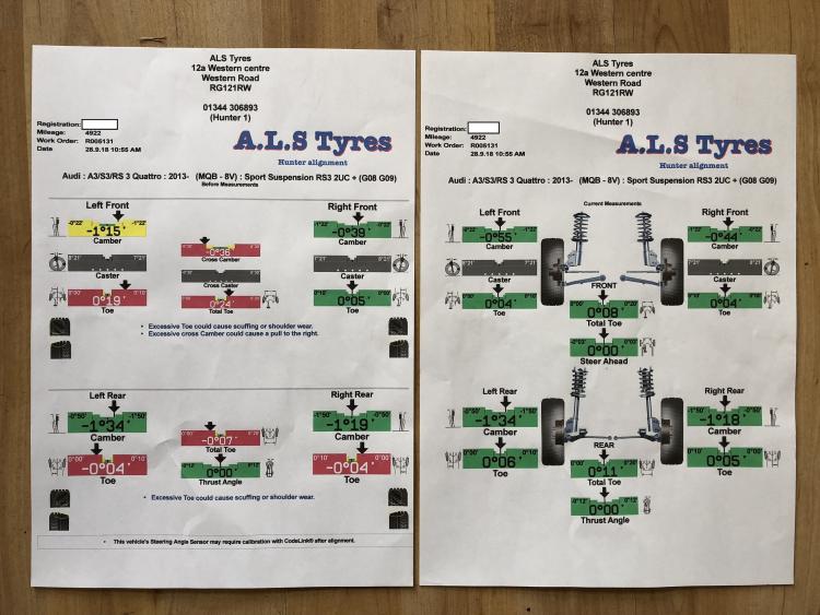

@fivepotfan Can you post up your alignment sheet or comment on the Castor alignment.
If Castor is out, on full lock turn in, the wheel is forced onto a sharper edge angle. Can't find the words to describe it but there's probably a technical term.

Here you go....... the tyre that I posted above was removed from the car BEFORE the Eibach lowering springs were fitted. The left hand alignment chart with all the errors is the result after letting the suspension settle for a couple of weeks. I cannot say for sure if it was that bad before fitting the springs.
Why are there no reading for the Caster ?
I see what you mean....box is empty! Interesting!

Caster is on the chart......third box down from the top.
Caster on that print out is the middle greyed out box. i.e Second box from the top.
Third box is front Toe
Mate I'd get it to a reputable garage asap. That print out is very odd and looks like a deliberate attempt to hide the results.
The rest of the numbers look exceptional. Makes me wonder if they sacrificed something on Caster which in turn is scrubbing your tyres.
