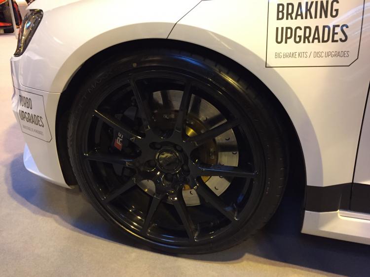

REVO have been running these discs on their demo car with different wheels.
