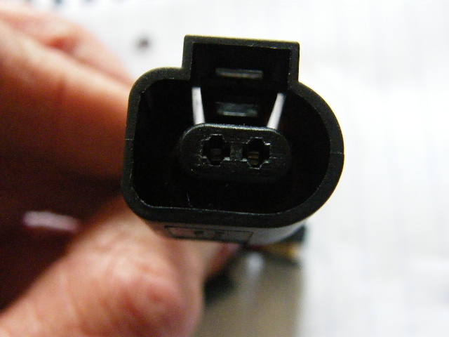

Yeh plugs look similar and lock together, it's inside the plug that is the issue with 2 male vs female pins
I've got the rs4/5 oe brembos pads out of the car now so I'll take a pic

Ok I can confirm
Car side is 2 pin male connector
Pad needs to be 2 pin female connector

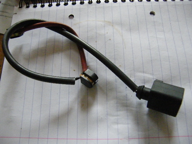

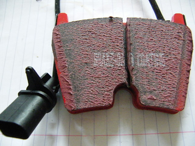

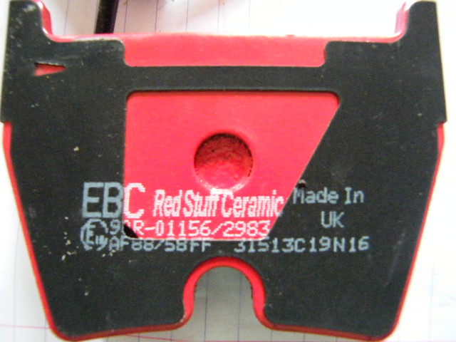

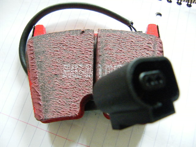

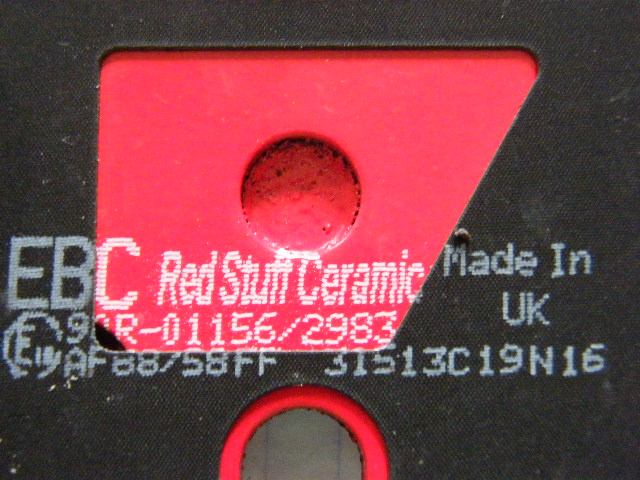

Redstuff pads arrived today.Perfect fit in calipers.Slid in a lot easier than the OEM ones.Bought a wear sensor from fleebay and soldered the correct end on the pads.Simples.

How many wear sensors do you need? Just the one?
Just one.Offside.

Caliper stays where it is.Pistons push back easily with finger pressure.Once wheel`s off takes 2 mins per side.
Pretty similar to the 8p
Tap out the anti-rattle pins, remove the anti-rattle springs then pads slide out towards you
There's a cutout for a caliper 'peg' in the pad, this locates them in the caliper housing.
No need to remove caliper.
