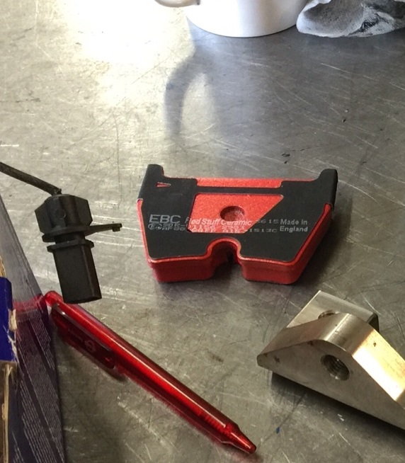

RS4/5 are same physical fitment but sensor was a male plug iirc and the car plug is a male (or that might be female I can't remember exactly)
Same with the oe brembos I got from vandit. Luckily my shop had an old set of pads so I cut and spliced the sensor onto the brembo pad to fit

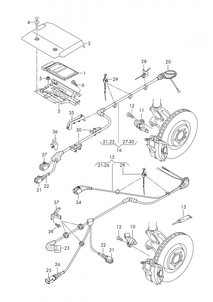

Number 25 is brake pad wiring connector

You can see the Redstuff plug just to the left......
