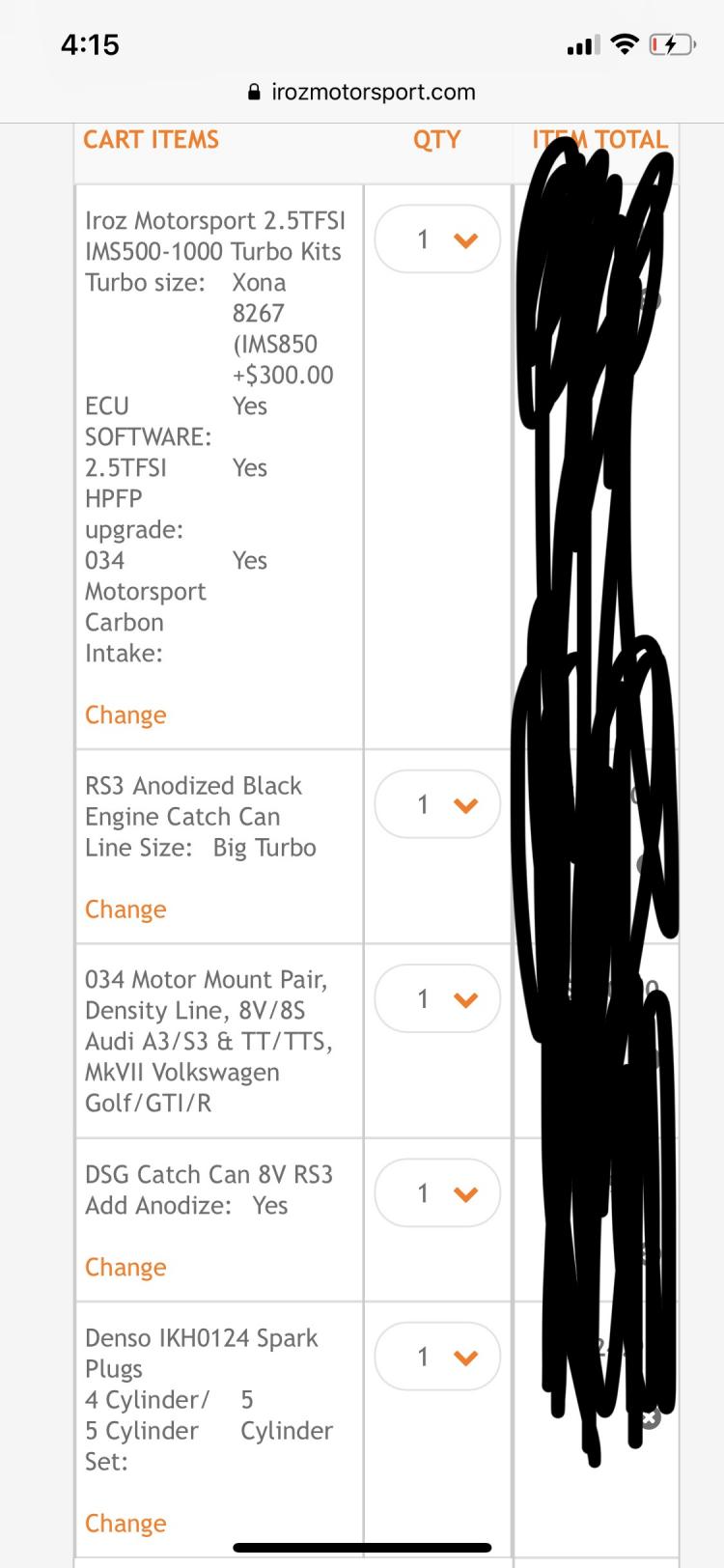

Posted 17 April 2019 - 10:09 AM
Rpc kit with injectors and miltek catback
And the fabrication of a joiner for downpipe to cat back,
Don’t know why I need the miltek catback tbh but that’s coming in around the 12k mark
Iroz ims850 kit with fuel pump upgrade and ie intake and iroz intercooler and the dsg and engine catch cans comin in close to 18k
3rd option I have is to source direct from iroz same as above iroz kit and extras coming close to 15k dollars which is around 11.5gbp

Posted 17 April 2019 - 10:11 AM
Where as the ims850 is a full frame.
3rd option will need mapping preferably by custom code who does the iroz mapping for them, that would be close to 1k gbp.
Posted 17 April 2019 - 10:13 AM
The rpc kit quote didn’t include additional intake and intercooler so I’m assuming a change is not needed to my current setup.
Iroz kits have not been ran on forge intercoolers yet so there are no figures or comparability proof.
