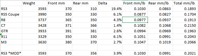

Maybe Dell, maybe......
I found this comparison chart a guy has done on another site......
Bottom details are after a rear disc size increase....
EDIT...I've a feeling that RS5 front discs are actually bigger than on the chart so that is incorrect.
Edited by T-800, 11 May 2018 - 12:10 PM.
Interesting to see the other sporty cars running similar disc size front and back vs RS3 that doesn't.
So you were correct to fit the bigger rears TX
Now take those Calipers down to numpty HQ and sling them at the powers that be......
That got you thinking. 🤔
Like dog with a bone mate.😂
So is it the calliper or the disc that has the advantage? I’m still only on bigger rear disc on stock calliper so wonder if it has the same advantages
probably a little of both.....
Bigger disc, bigger pad in the 4 pot rears so bigger 'swept' area, four pistons giving more clamping force especially as they are further out from the centre of the 'circle'
