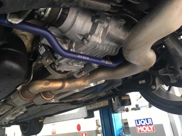

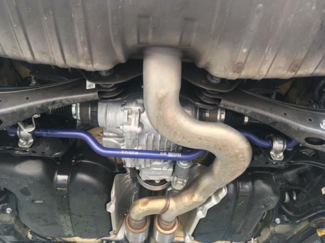

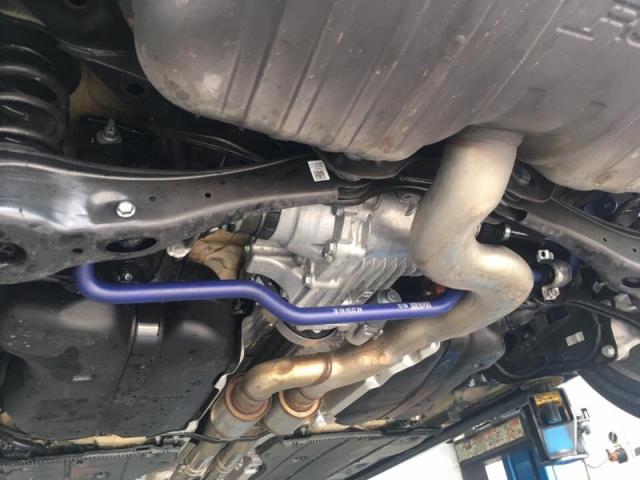

there is only one setting on the H&R, its a strait swap for the OME , the work shop i used ordered it from H&R Germany rear only , it arrived within a week down under , installation took 45 minutes, (useless information the color of the sway bar is blue)

hi all i have attached photos for the H&R rear bar mod
