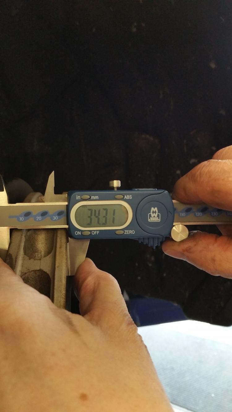

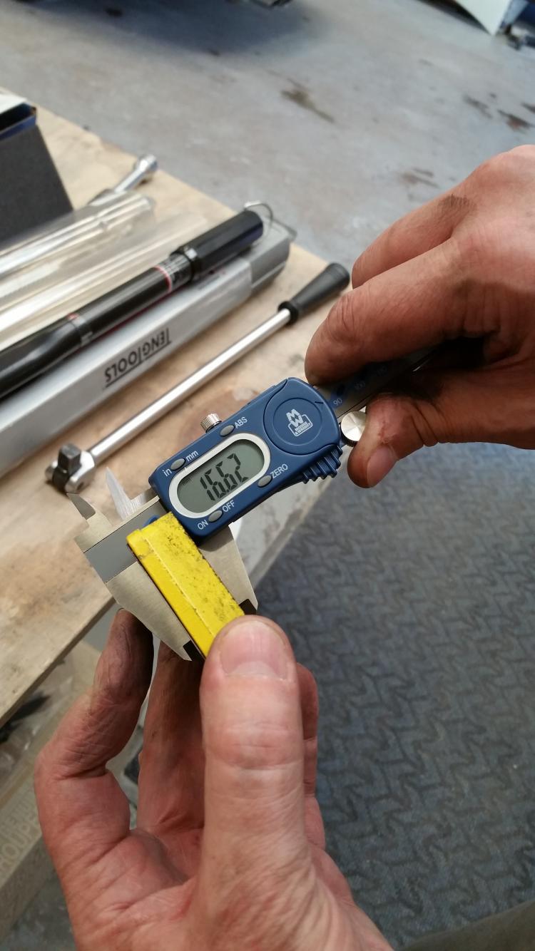

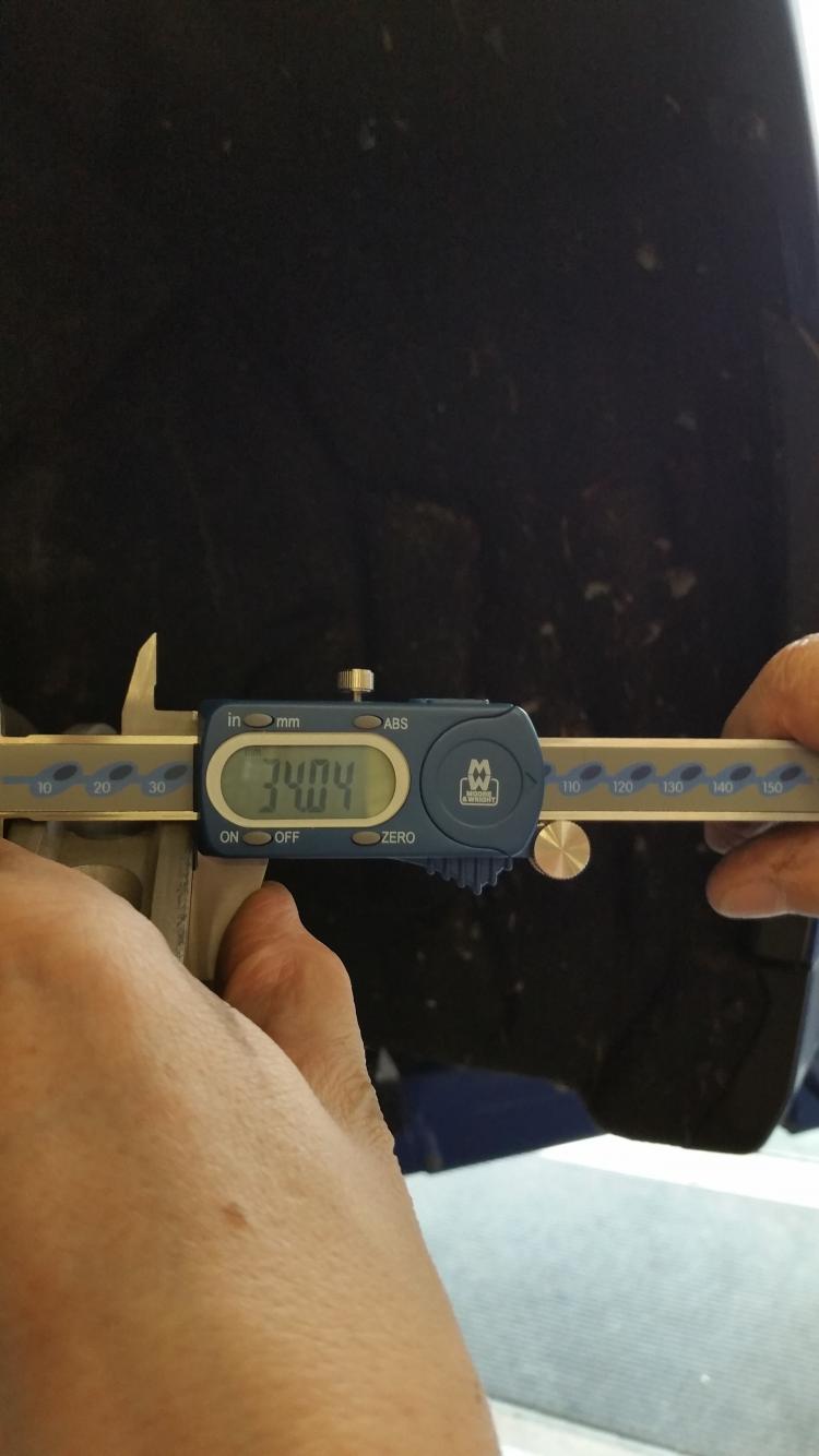

For those that were following the Tarox discs thread (sorry can't past the link here because the forum software is broken) I have now fitted the replacement discs and RS29 pads.
The issue with the original Tarox discs and RS29 pads were both caused by them being oversized.
1st set of Tarox discs @ 34.31mm and they should have been 34.00mm
2nd set of Tarox discs @ 34.04mm
The Pagid pads were @ 17.25mm and they should have been 16.5mm, I had a new set ground down to 16.6mm pending delivery of new stock with the correct sizing.
The upshot is that the pads and discs now hang together correctly, I have not bedding them in yet and it will be a couple of hundred street miles before I do so to ensure that the pads and discs faces have fully mated, I also swapped out my brake fluid today, the OEM brake reservoir is a real PITA to see the level even with a light shining on it! I will report back one I have carried out the bedding cycle.
I think that both Pagid and Tarox come off a little poorly in this, both of them need to tighten up the QC stage of their manufacturing process, both of them have been alerted to the issues and have acknowledged them.

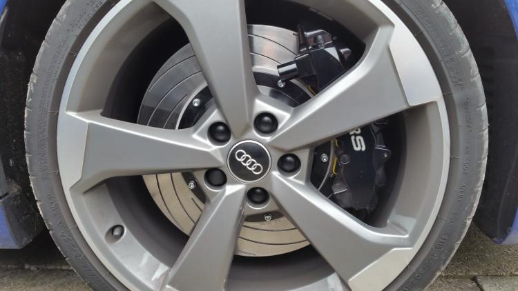

Trackday use of Tarox Discs Update:
The front discs and pads performed just fine with zero fade issues. Once the pads and discs were up to temp they were silent in operation, during the warm up process I adopt to get the temps stable there was some pad groan but that was expected and normally happens with the RS29 pads, I have had this same experience on 3 different vehicles I have used the RS29s on with different discs makes.
There is still the venturi noise that you get from the billet discs cooling "system" which can be intrusive at times, I can't see what else could be causing the noise like a failing wheel bearing as even if you apply the brakes lightly or hard the noise remains and if it was pad/disc face pattern that was contributing to the noise I would expect that to change on brake application.
The rear Tarox discs with Yellow Stuff pads worked flawlessly and can be 100% recommended.
