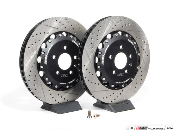

ECS
ECS has a number of different styles and options available, rather than list all of them, i've narrowed down to the few I think look the most interesting.
Front
Two piece, semi floating, drilled and slotted. £828
ECS are an American company that I believe are well regarded and they seem to make some tasty stuff. The front discs are available with two different styles, the first is this;
es2603007__05703.1449614592.1280.1280.jp
https://www.awesomeg...-brake-discs-1/

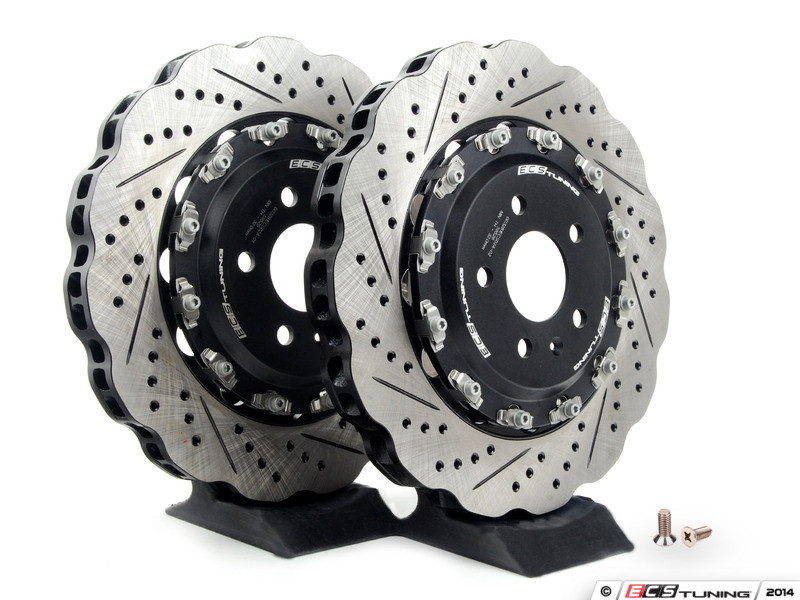

The second is as above but uses the same 'wavy' design as the OEM front discs, as well as featuring what looks like a more involved floating mechanism, which is nice... These are £983
es2785596__86772.1449614592.1280.1280.jp
https://www.awesomeg...ce-brake-discs/

Same as the front 2 piece non-wavy - £517
Single piece is also available and much cheaper, but I haven't been able to price it in the UK;
https://www.ecstunin...tors/ES2189770/

I should point out if you are considering a brake disc change, the Ecs discs are currently NOT compatible, unfortunately!
