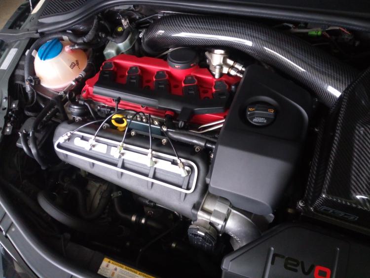

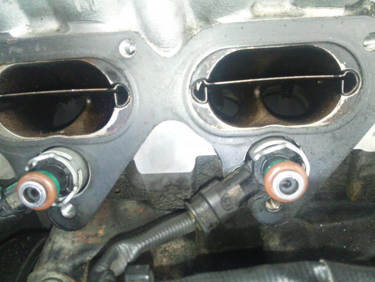

I thought I'd update this thread with my experience on the runner flap delete from a few months ago.
TLDR: as others have said - don’t remove the runner flaps.
I started off removing the upper intake to check the flap retaining bolts were tight & was going to install WMI port injection to supplement the single pre throttle nozzle the car has been running for >50K kms. The good news is the intake valves were in good shape.
But then I dropped my T30 tool into a spot I couldn’t reach without pulling the rear intake manifold, including the high pressure fuel rail. Bummer, but I had planned to install the WMI nozzles into the individual runners so off it came with a little cursing.
So I was thinking about the quote below from an owner in USA that had (at least) one of the flap bolts work loose & he removed them all (I linked it a few posts above).
Two days of driving and a few restart cycles later I am happy to report that the car runs great, throttle feels a touch more responsive and motor seems to rev more freely.
What are the downsides you ask? Audi must have a good reason for these flaps. Turns out they do. On cold starts when the RPM is higher for the first 30 or so seconds I get a little stumble and ECU records some misfires but no CEL is triggered. Once the RPM drops to its steady state idle, these misfires die down to zero - I was logging using VCDS and that's the only way I could tell this was even happening.
After that car runs as usual. Second downside (some may actually like this) is that I can now hear a very muted intake whoosh, similar to what one hears with those cone filters on a stick but much lower volume”.
Because I was so far in I decided to delete them along with the dividing plates, put in new injector seals & put it all back.
Contrary to what our American friend said, these were the downsides I experienced afterwards.
·         Cold start was louder & engine revs hunted (trying to find correct AFR?)
·         During cold start, the car ran super rich & spewed a heap of unburnt fuel smoke out the exhaust. No fuel smoke once cold start cycle finished (~10 - 15 sec in my case).
·         Highway driving on cruise control (flat road), the car would occasionally jerk/hesitate fractionally.
·         The tone of the (Milltek) exhaust changed to more of a drone when on light throttle/highway cruising.
·         Light throttle changes no longer resulted in smooth driving.
·         I didn’t find any noticeable performance gain.
·         My wife hated it.
Granted, a retune with the flaps removed could probably fix most some of these issues, but what is the point when there was nothing to be gained?
Intake back out, re-installed the dividing plates & runner flaps with loctite on the bolts.
During this process I realised it would be difficult to fit my WMI nozzle holders into the space available on the individual intake runners, & maintaining nozzles & tubes buried down there wasn’t going to be easy. So I did the direct port WMI installation on the top plenum as so many others have done & it works well with easy access to check/clean nozzle filters when required.
  • 1,310 posts
Great post for the flaps delete and reinstalling them.
What WMI are you running?
