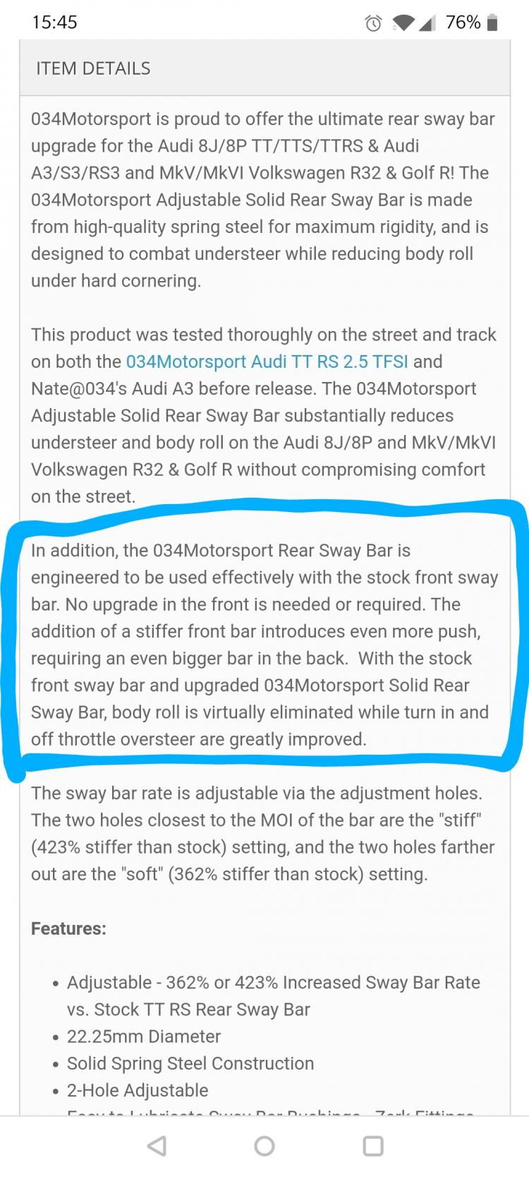

Did you all just fit the rear, or did you fit a front one as well?

Rear only for me. If you do both the car is just stiffer and no help with under steer.Did you all just fit the rear, or did you fit a front one as well?
