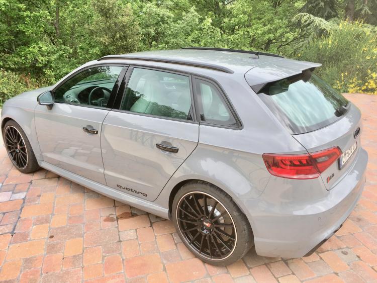

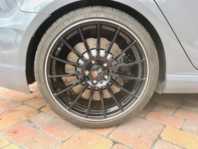

  • 252 posts
Hal, what full setup do you have? any pics?
Oli - yes, attached. Other than the larger rear discs, the set up is standard. As I say, the extra braking on the rear will be negligible, but I just could never get to grips with looking at the tiny rear discs in comparison to the front. I am sure no one really gives them a second glance, but there you are!
