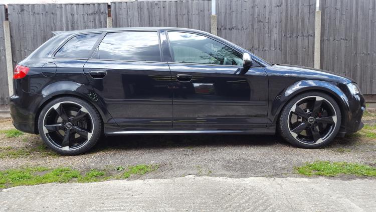

I had my OEM gray wheels refurbished in gloss black  :)
Edited by RS3Dell, 29 December 2017 - 05:52 PM.
RS3 8P 2012 Phantom Black, Bucket Seats,Optic Black Pack, MRC Stage 2,+ DSG Remap, Forge Intercooler, Autotech HPFP, HG Motorsport Intake Pipe, Pipercross Airfilter,Powerflex Gearbox & Dog Bone Mount Inserts, Fully Decatted OEM Exhaust, 443Ps 777Nm,Reyland 2 piece Discs & DS2500s All Round,Bilstein B14, 034 ARB.MPS4s,VCDs User.
