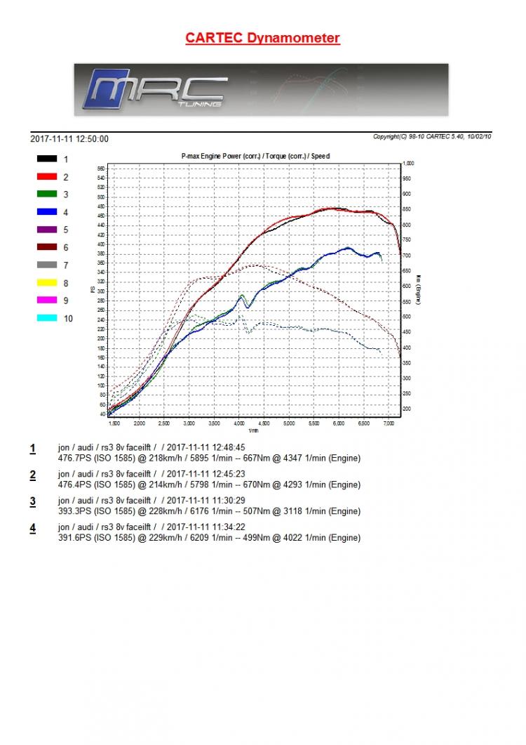

I know it's an aluminium block now, but what else has been updated/upgraded on the FL engine that they can push hybrid turbo numbers on a map? I know MRC might be either 'optomistic' with their dyno, or just pushing for peak numbers rather than flat torque etc etc, but 476 on a map seems like they've got more to play with now.
We were wondering the same earlier today.
T-800 has started a new thread ('Facelift engine changes' in General Chat section) which hopefully will begin to tease out all the updates that Audi have made to the 5 cylinder motor.
The new Borg Warner turbo is upgraded over the previous model, intake plumbing is different, the IC is supposed to have improved flow (but externally looks the same as the old one), and an extra row of injectors have been added (but not sure if this is just to do with emissions or helps with power too) - Lots of new things to learn about!
