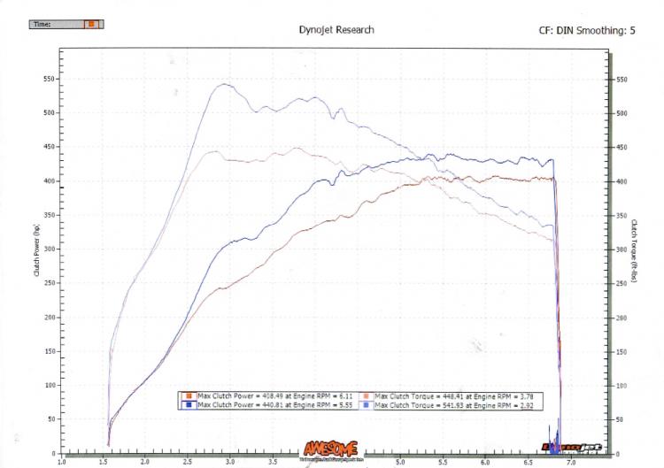

After running the APR stage 1 map since October 2016 (running circa 390-400bhp), the car was fitted with a Forge intercooler, Milltek downpipe with sports cat and an 034 Motorsport intake by Awesome GTI more recently. As this was stage 2 hardware but only running stage 1 software, APR developed new maps for the RS3 8V, the stage 2 and the stage 2+. The difference between the two is the stage 2+ utilises a high pressure fuel pump, either APR's own or by upgrading the internals of the stock pump.
With APR Stage 1 and the Forge intake and Milltek downpipe and sports cat, the car ran a respectable 408bhp and 448lb-ft.
After the stage 2+ map was uploaded and the hpfp internals upgraded, the car ran 440bhp and 541lb-ft! Best of all, the increase can be felt right through the rev range with a huge increase in the midrange. The car pulls smoother and with more urgency lower down the rev range when off boost which makes driiving around town so much better.
Once again a fantastic service from everyone at Awesome GTI for such a quick turnaround of the car and the rolling road runs.
